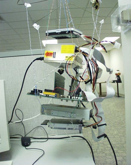

Postat 19 October 2007 - 10:33 AM
UMOR: probabil o sa arate ca in foto... :o
  • Imagine atasata: post-36-1192782787.jpg
