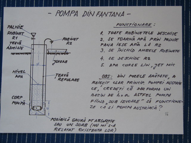

[B]SCURT ISTORIC.CU PESTE 80 DE ANI IN URMA, UN BOIER DIN MOLDOVA A ADUS DINTR-O TARA APUSEANA (GERMANIA, FRANTA??) DPUA POMPE PE CARE LE UTILIZA PENTRU SCOATEREA APEI DIN FANTANA LA CONAC SI LA CAMP PENTRU RIDICAREA APEI
DESCRIEREA POMPEI: ACEASTA ERA COMPUSA DINTR-UN CORP © DE FORMA CILINDRICA CU CAPACE DE FORMA SEMISFERICA (TOTUL DIN FONTA), UNA DIN PARTI AVEA O TEAVA (ADMISIA) CARE IESEA DEASUPRA NIVELULUI FANTANII SI AVEA CAPATUL PREVAZUT CU UN ROBINET R1 IAR DEASUPRA O PALNIE (P). DIN CELALALT CAPAT AL CORPULUI IESEA O ALTA TEAVA (REFULAREA) USOR INDOITA LA CAPAT SI PREVAZUTA CU UN ROBINET R2.
INSTALARE: CORPUL POMPEI ERA CUFUNDAT IN FANTANA PANA APROAPE DE FUND, IAR CELE DOUA TEVI - ADMISIA SI REFULAREA - RAMANEAU DESUPRA GHIZDURILOR (MARGINEA SUPERIOARA) FANTANII.
MOD DE FUNCTIONARE: 1. SE DESCHIDE ROBINETUL DE PE REFULARE R2 LA FEL SI ROBINETUL DE PE ADMISIE R1. 2. SE TOARNA APA CU GALEATA PRIN PALINE UMPLAND TOT SISTEMUL PANA INCEPEA SA CURGA APA PRIN ROBINETUL R2. 3. SE INCHID ROBINETELE R1 SI R2, DUPA CARE SE DESCHIDE ROBNETUL R2 SI APA INCEAPEA SA CURGA LIN FARA SA AIBA UN DEBIT MARE. DE REGULA APA CURGEA IN PERMANENTA IN JGHEABUL FANTANII DEOARECE IZVOARELE ERAU PUTERNICE. DACA SE DESCHIDEA SI ROBINETUL R1 SISTEMUL SE DEZAMORSA SI APA NU MAI CURGEA PRIN ROBINETUL R2. POMPA CARE ERA INSTALATA LA CAMP URCA APA LA BAZINELE DE PREPARAREA SOLUTIILOR PENTRU STROPIT VITA DE VIE.

Cornelius, la 19 May 2007, 16:21, a spus:
NU ERA DUPA PRINCIPIUL VASELOR COMUNICANTE SI NICI AL LOVITURII DE CIOCAN. LOCUL UNDE AU FOST MONTATE SE AFLA IN COMUNA BUNESTI-AVERESTI SAT AVERESTI LA 17 KM DE HUSI, JUD. VASLUI
ai putea sa scri fara caps lock? nu tre' sa tipi la noi
asa pe langa asta...dupa ce principiu functioneaza pompa asta? ca descrierea aia pt mine nu are nicio logica

Imi pare rau, nu cunosc principiul, asta caut si io sa aflu

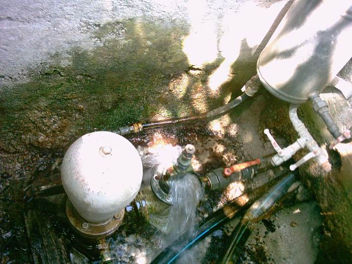

Prin coloana de apa am vrut sa spun o tzeava de 1 tzol de lungimea 20-25m care leaga izvorul cu acumulare de pompa la un unghi de 10-15 grade adica o diferenta de nivel de 2-3m.
La lucru in original.Se observa supapa de refulare care e un pic mai mare cala pompa precedenta.

Postat 20 May 2007 - 03:32 PM
Din alt unghi
  • Imagine atasata: post-8-1179667973.jpg

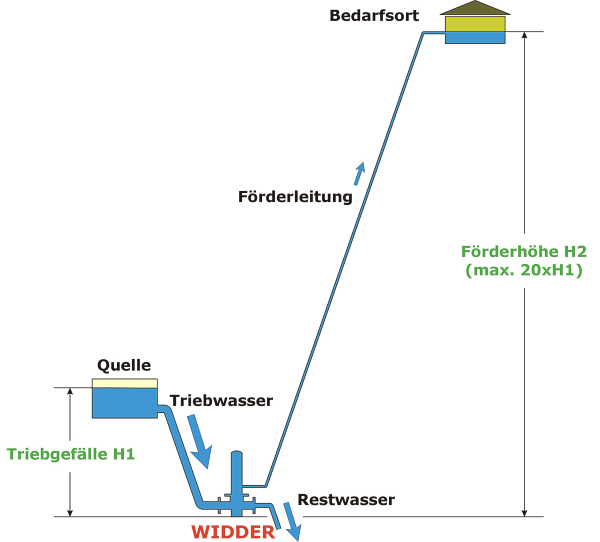

Si iata cum e principiul de functionare cu adevarat
  • Imagine atasata: post-8-1179681175.gif
